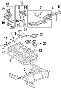

According to Autocenter.net MITSU does sell the fuel filter separately for $4.93. It is item #20 on the attached diagram. Has anyone actually bought this filter and proven that it can't be replaced?
I think $107.04 for a new fuel filter by buying the entire assembly seems pretty extreme.
