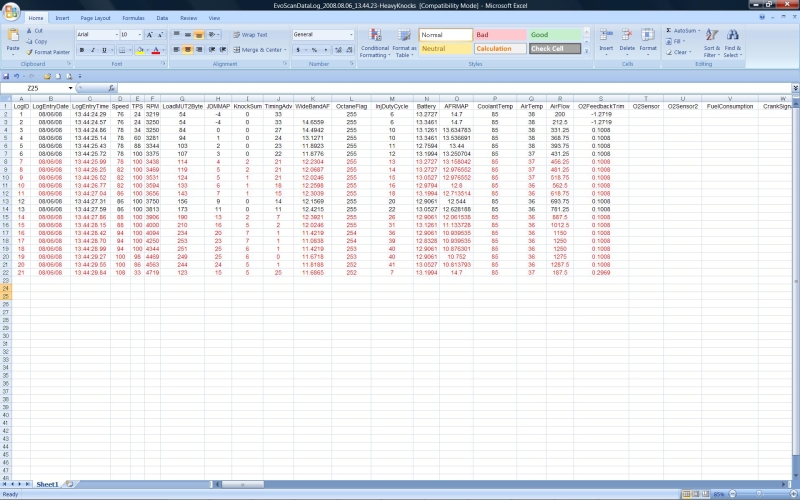

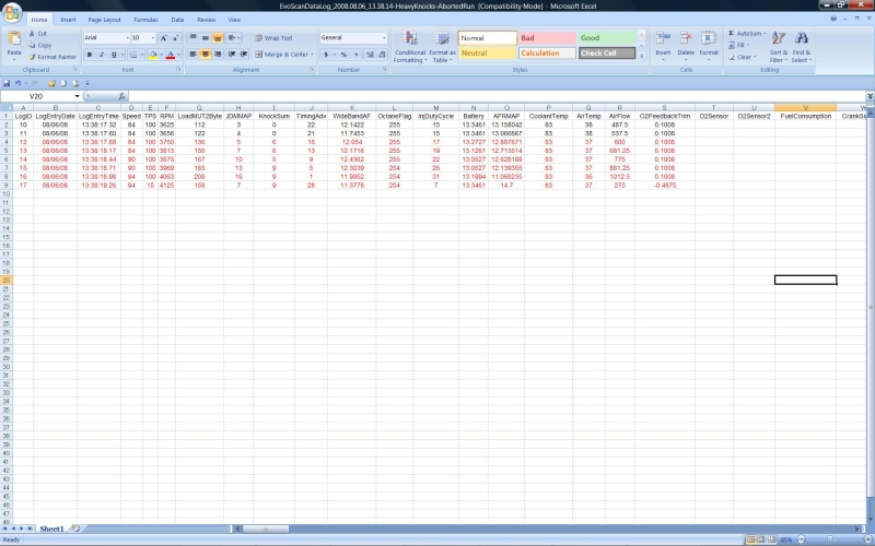

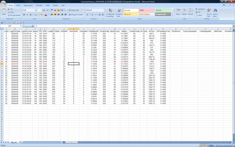

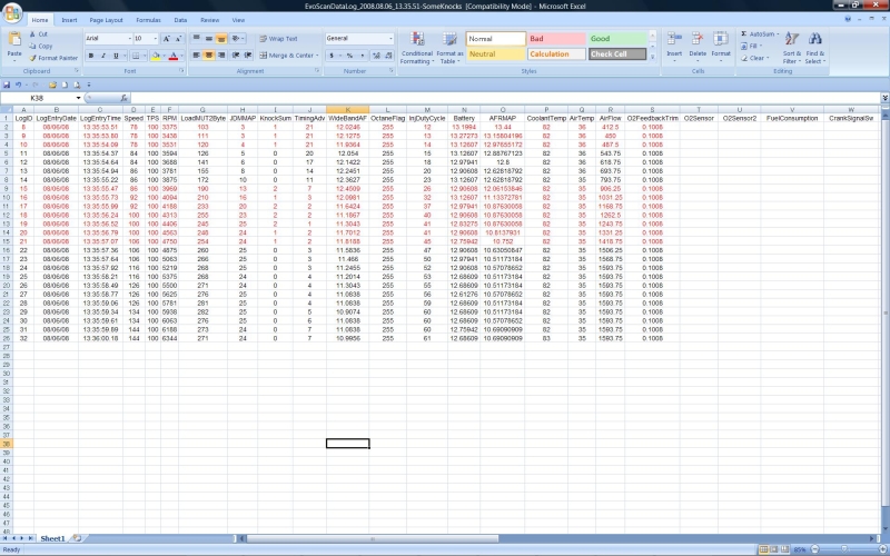

All the runs are done in 4th gear and boost set at 25PSI
This run is good...just 1 count of knock
This run has some knocks but timing is still ok
This run started knocking early and continued so I aborted it.

So long as knock starts from the lower RPM, the car is going to run like crap all the way up with timing pulled everywhere. That is what I meant by having inconsistent runs...I have no idea when the knock sensor will detect knocks and start pulling timing. Its very frustrating driving the car in this form. I have to say my initial estimate of 80% of the WOT runs being good is out...its worse than that I have the CEL patch and once I see it flashing, I stop the run.
