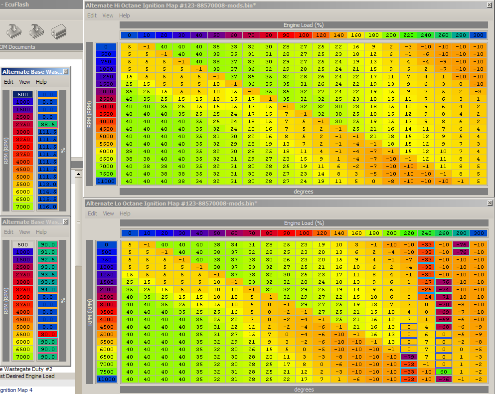

88570008 UNTESTED
This rom is bugged I think.
Alternate Hi Octane Ignition Map #123
Alternate Low Octane Ignition Map #123
Alternate Base Wastegate Duty #1
Alternate Base Wastegate Duty #2
Alternate Boost Desired Engine Load
all don't seem right

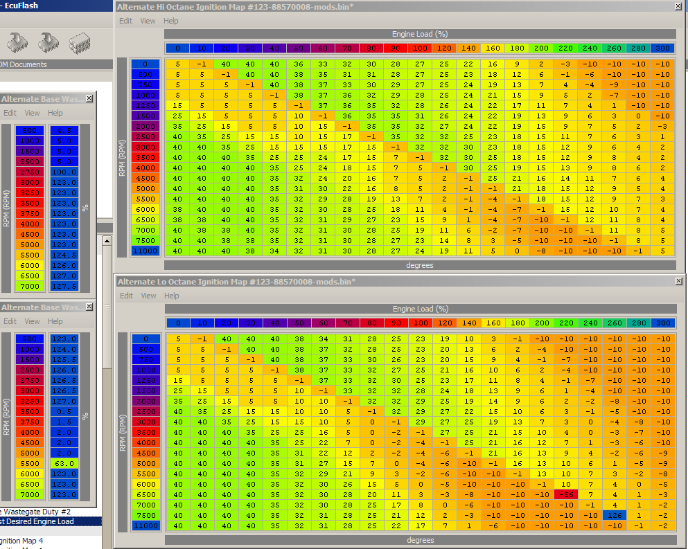

#442
The alt map ignition tables are wrong (should be 19 rpm lines instead of 20).
And if you alter:
It changes the alt low octane ignition map.
And if you alter:
