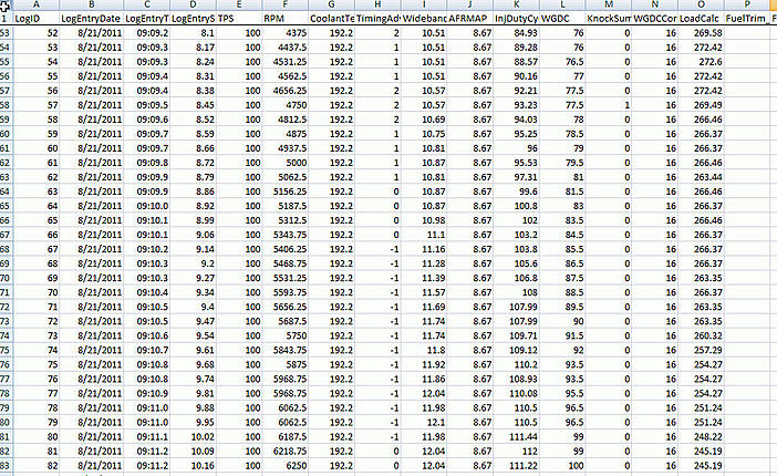

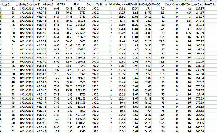

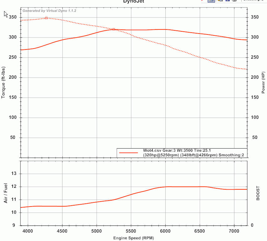

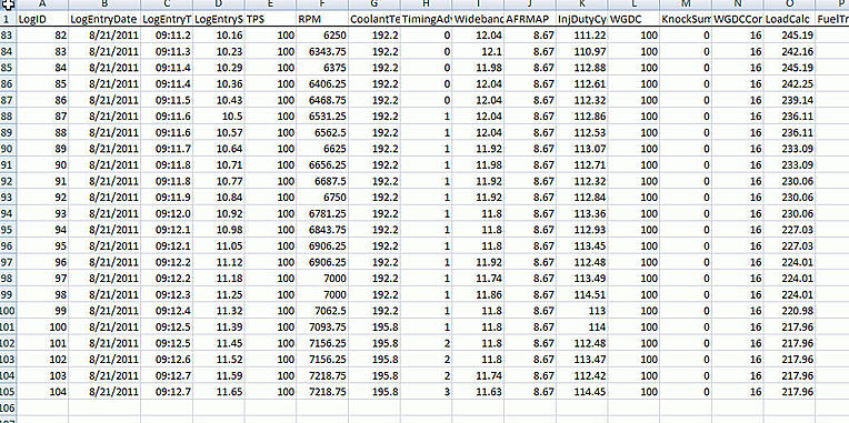

Did a bit of fine tuning, I cannot get the power to stay up towards the redline. I have included snapshots of my log aswell as a VDR chart.
And I was wondering how does my logged timing look? Any more timing and the car starts to knock ( peak and up top). My AFR is a bit on the lean side due to my injectors maxing out up top. Also if i try to lean out my AFR between 3-5k my car starts to knock. Any suggestions? Does this look safe? From what i know IX's are suppose to run more timing up top. Please advise.

honestly the timing looks like crap. there is no reason to ever see negative timing, as well as timing should increase, never go down as you go up the rev range. im assuming cali=91 octane right?
turn the boost down and put more timing in.

Timing looks WAAAY low. 3 deg at 7k? I bet egt is through the roof.
Also looks like your WGDC needs to be adjusted. Why is Correction pegged at 16?
Id start by checking over everything. Boost leaks, plugs, etc. Something definitely looks off. Also, Im fairly positive that stock inj should be fine for 25-22 on the stock turbo. Maybe the Walbro makes more difference than I thought, but def doesnt seem right to run out of inj with your setup.

That high of WGDC Correction could also be due to a boost leak and the system is trying to compensate.

Yes guys this is on 91 octane,
I have checked for boost leaks and have none, Timing is actually set up this way because if i throw any more timing the car starts to knock.
I did read up on high EGT's and that is my primary concern which is why i wanted to double check these numbers.
I will install my Walbro and try to throw more timing at it. And lean out the midrange as im seeing AFr in the 10's

If that is really all the timing that it will take, something is definitely wrong. I know Cali 91 is crap, but it cant be THAT bad.
You still may need to double check mechanical issues. Cam timing, compression check, replace plugs, boost leak test. Installing a Walbro may help if you are indeed running out of injector.

Sounds good I have made a new Timing map and will try to Get it to run safely... Running about 2* peak torque With all the way up to 6* in the high Rpm range. Also i will upgrade the fuel pump before making any other changes.

the JDM mivec could explain the high IDC, as ive seen examples lean out a tune almost a full point.
i would put in the injectors and pump and get the fuel curve where you want it then go after the timing.
ive run out of injector imho on my car at 330/300 on 24psi on 93 octane, but i personally dont like idc's over 100. so its very possible you are truly out of injector in my opinion.

you want more than 6* at redline.
i am running 16* at redline, but my boost tapers down to 16 psi

Ok guys i tried throwing some timing at it as well as leaning out the car during spool up. I guess the car wasn't taking any timing because it was too rich? does that sound about right?
I leaned out my whole boost curve to about 11-11.5 AFR because previously i was dipping into low low 10's. Now at peak tq my car is about 1* of timing and in the upper RPM's i had to add fuel and its taking about 5* of timing by redline.
I do get 1 count of knocke here and there, Is that acceptable with 91oct and 25psi? or should i turn down the boost to completely eliminate knock?
