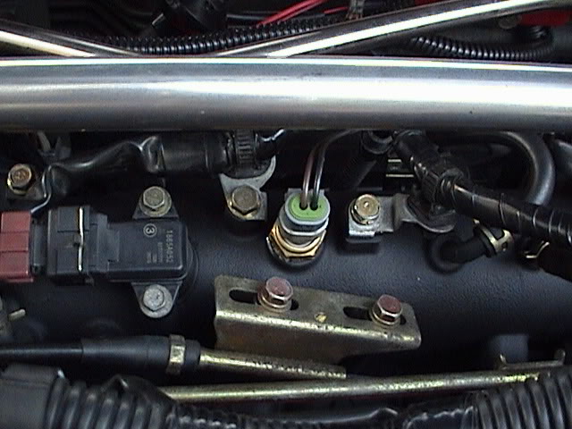

I think I am going to mount the GM IAT on my intake manifold in the area that is used for IAT on the uk models, it is the bung we have on our USDM models but is not tapped.
I am swapping out my intake manifold soon for a ported one so it will be the prefect time to do it. |

1 Attachment(s)
