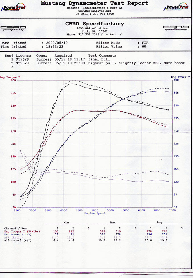

i use exxon 93 octane gas and drive the car daily since it is my only ride. it ended up making 385hp/320tq at 26 psi. i ended up dropping the boost a litlle and pulling some timing just to keep it safe for daily use. its runing at 375hp/315tq as of now. im interested in checking out the cbrd front mount inter cooler and a retune to see if i can pull a litlle bit more out of it. if everything works out ill update with the new numbers.
here is a link to one of the dyno pullshttp://s678.photobucket.com/albums/v...t=DSCF1121.flv
and a dyno chart

Perhaps its tuned like a MBC and has taper induced, but you should be able to keep your boost curve a bit more flat with a proper BCS setup (if I'm reading hte graph right, looks like it tapers down to like 21psi by redline?). I have an almost flat 24psi from boost onset to 8000rpms with my BBK full. Really though, it almost doesn't matter; we put down nearly identical numbers.
Have fun with it!

thanks for the kudos jeff-
in response to the curve.... the car was a bit knock prone up top.. so i pulled some timing and tapered the boost curve to suit
cheers

Congrats on the #'s.
Seems like that BBK is a very good stock framed turbo.
To make it a little easier to read, here's your chart.

Ya, one thing I've noticed that doesn't seem to be discussed too often is that IX's seem to like timing more than boost and will often make similar or more power with boost tapering a bit up top and running a bit more timing, versus more boost up top and less timing (seems like VIII's perfer this). Never anything wrong with dialing back both for a more conservative tune though. Reliability > power

Looks good, all these BBK graphs popping up are super linear and seem to climb all the way to 7500 and more..

looks good....12.3 AFR'S??? whats that about....a bit lean?...no?
