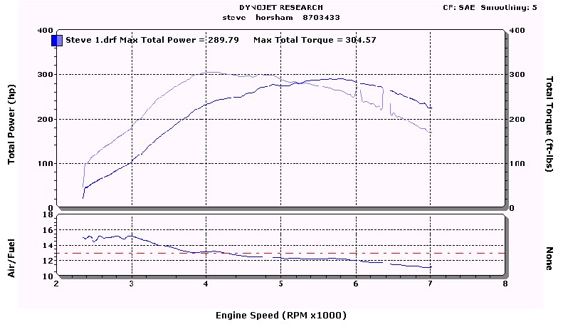

So far the cams have been a huge disappointment. Kracka and I both were tuned for the addition of injectors and cams on the same day by the same person and we made within 1 hp and 3 tq of each other. As Kracka mentioned our cars are very similarly modified with the only real difference being the brand of a few of our parts.
Kracka's numbers and power curve were nearly identical to his pre-cam and injector numbers effectively meaning that the cams provided no real increase in power (peak and under the curve) for him and most likely did not add anything for me (I had not been dyno'd or tuned prior).
What the cams did for me was add starting issues when the coolant temp is at 130° F +/- 20° F, idling issues, phantom knock at throttle tip-in when between 3,000 and 3,500 RPM, low speed drivability issues, and recently my AFR's at idle have been bouncing between 19.0:1 and 13.0:1—nearly stalling at the lean end and revving up above 1,000 RPM on the rich end.
The question in my mind is; why aren’t we making any power on the cams? Is it not possible to do so on these cams with a stock turbo and stock head? Are they ‘too aggressive’ for our relatively mild set-ups?
At this point, I’d rather switch back to stock cams than spend the money on new valve springs considering this could only potentially be an issue.
Are we missing something?
For reference, some dyno graphs. After these we pulled some timing out of the upper load/RPM ranges due to knock I was seeing on the street but not on the dyno and I made just over 350 hp/tq on a Dynojet. Since installing a FMIC we added the timing back in and have not seen any knock.

That being said, my strong HP taper in the upper RPM's could very well be caused by the issues Greg brought up. The car felt like it wanted more timing up there but it just wouldn't take it without knocking. Kracka's car has a better power curve in the upper RPM's but he's also able to hold more boost up top with his GM BCS...I'm just running a Joe P manual boost controller but will be switching to GM BCS within the next few months.
Zac, my car made the most power tapering boost down similar to how yours was so I don't feel my ability to hold power better has to do with boost. After over-laying my dyno charts, with the addition of cams and GM BCS, my spool was no sooner or later than with stock cams and a MBC and power held up top was nearly identical. With the recent addition of the FMIC I'm hoping I'll be able to make even more power up top since I can run higher boost on the same timing (or run the same tapering boost with more timing).
