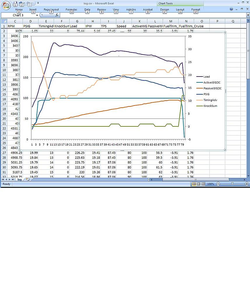

hi,
i just did some logging and it looks like my boost curve is not as smooth as i would like it to be, would appreciate feedback.
I want to get to say 21 psi and stay flat until 5500-6000rpm and then drop shlightly to say 17psi
i cant work with images on my new laptop so here is a log file and a graph inside it; you can see what is going with boost, load, wgdc, etc.
not sure exactly which boost tables i should be playing with to smooth it out. i increased the passive selonoid gradually to peak at 90%, i increased the boost limit offset to 110, boost target engine load, boost cut, fuel cut delay timer as well,
i appreciate your feedback
Dark Blue is load
Lighter Blue underneath is boost
Dark Blue is load

thats knock at the end of run as you bounce off rev limiter, forgot what its caused by, nothing to be concerned with.
DG Motors, i appreciate your suggestion but i want to keep stock actuator and selenoids.
anyone else want to take a look and tell me which tables i can tweak to hold the boost a bit better?
Thanks

One other thing, I would UNDO the changes you made to boost offset, boost target engine load, fuel cut, and boost cut. The last two are safety mechanisms that you shouldn't be hitting anyway. The combination of the first two would indicate your desired engine load, and are only used if you are overshooting your target load. It does not look like you are overshooting at the moment since your WGDC are still smooth and maxed out. Therefore, it would be safer to lower your boost target load to match the actual load you are hitting.
Note: target load = boost offset + boost target engine load table. This should peak around 240 and drop to around 180 at redline according to your graph. Having boost offset set at 100 makes it easier for you to do the math so you can set 140 as the peak in the boost target engine load table.

i am thinking about doing the pill upgrade anyways instead of actuator or 3port sel. mod.
i am thinking more that it could be my restrictive exhaust because time and time again, i am getting boost spike, then dip, and then boost builds itself back up. check out the spike in one of the logs, despite the fact that i have the primary sel. turned down to 95% max as opposed to stock 100%.
pulls done about 5 minutes of each other. first one is best one i got so far in tuning, second one you can really see a spike and also some knock in higher rpms
http://www.pltek.net/log1.csv
http://www.pltek.net/log2.csv
here is my desired load, primary/seconday selonoid, afr, timing, all of which have been tweaked (smoothed out mostly and made slightly bolder
